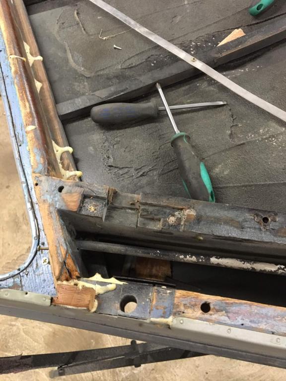

Frame timbers in doors re-glued with epoxy and holes filled and glued with dowels, the result is tight, solid timber frames in the doors, which now make a pleasing clunk when closing.
