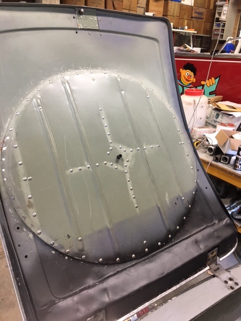

Bristol Boot lid inside finished - The boot lid was probably the most time consuming piece on the whole car. the outside skin had to be remade, the inside skin had to be panel beaten and then re-riveted together, the hinges had to be remade, the hinges mount onto a timber frame which was rotten which required the whole rear timber frame to be renewed.
