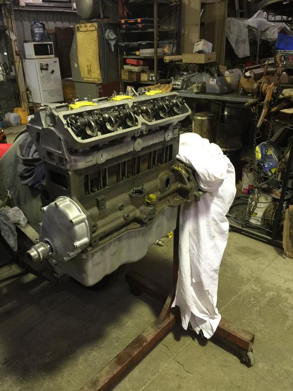

The engine finally assembled, new later model (lobe type) oil pump fitted. All tolerances on bearings, cylinders, camshaft etc to new engine specs.
The cam was reground to the profile of a 405 to give longer overlap
