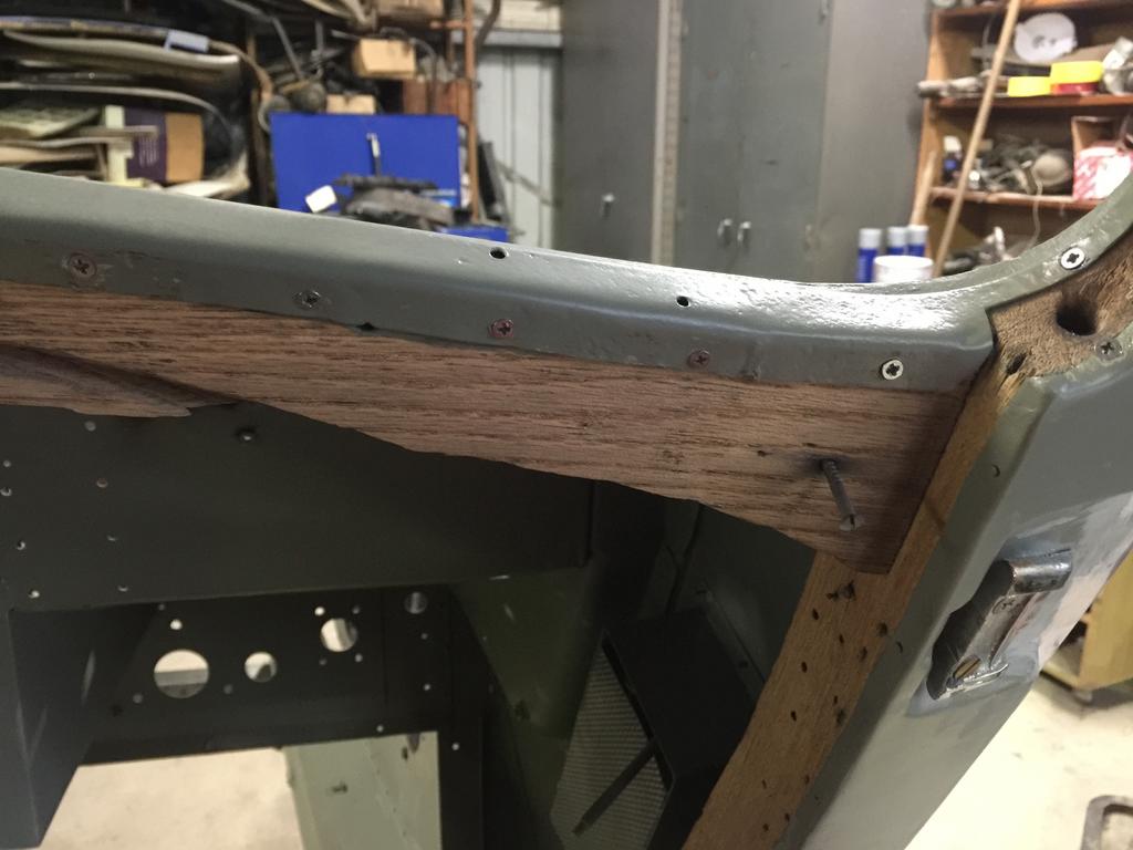

The steel body sections are attached to the timber frame with hundreds of small nails. Over time these corrode and become loose. We are replacing them one at a time with monel self tapping screws, a very slow painstaking task
