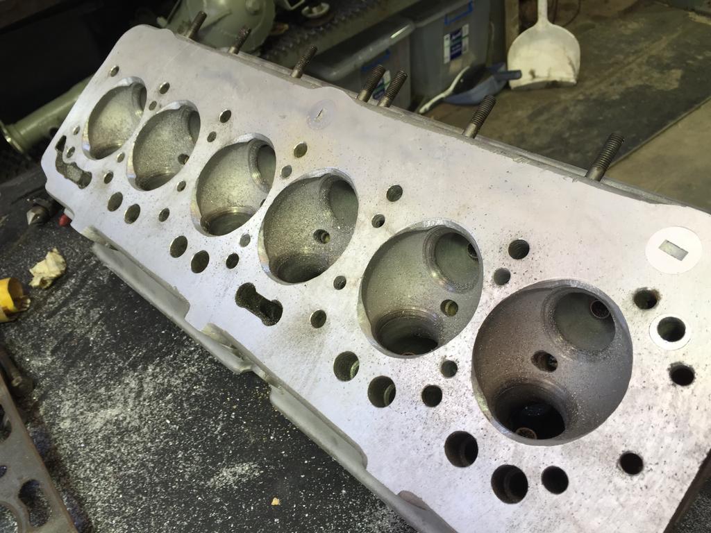

Cylinder head after cleaning and machining. Extra aluminium ground out in way of valves, water jacket holes drilled out
