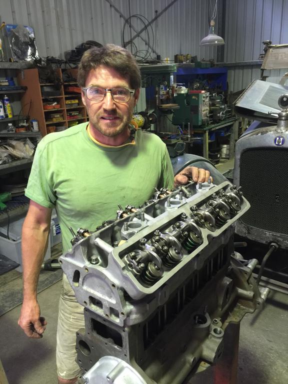

Picture 45 of 70 from Album 400 undergoing complete restoration in Australia
Sebastian with newly torqued down head. New pistons and rings fitted.New head studs, new o/s valves and guides reamed to fit. Solid copper gasket. Compression ratio should be around 9.5 to 1
