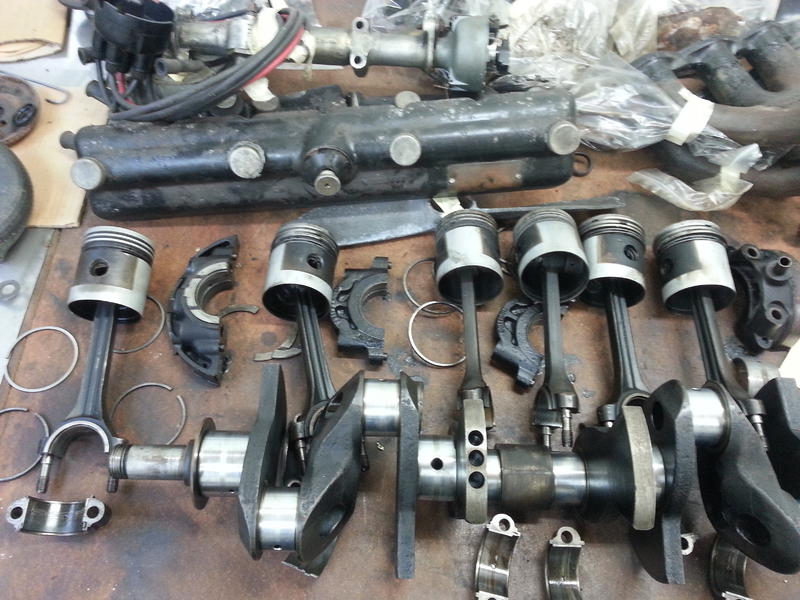

Picture 48 of 70 from Album 400 undergoing complete restoration in Australia
engine disassembled. Modifications will include bigger valves and competition springs, high compression pistons, camshaft grind to increase overlap, SU carbs to be retuned, estimated power up to 100 HP
