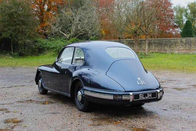

Please can anyone tell me if the rear lights on this very early (step sill) 401 are correct ...or have they been altered.??

I accompanied this car on a number of European trips and got to know the then owners pretty well. I believe them to be absolutely correct.
